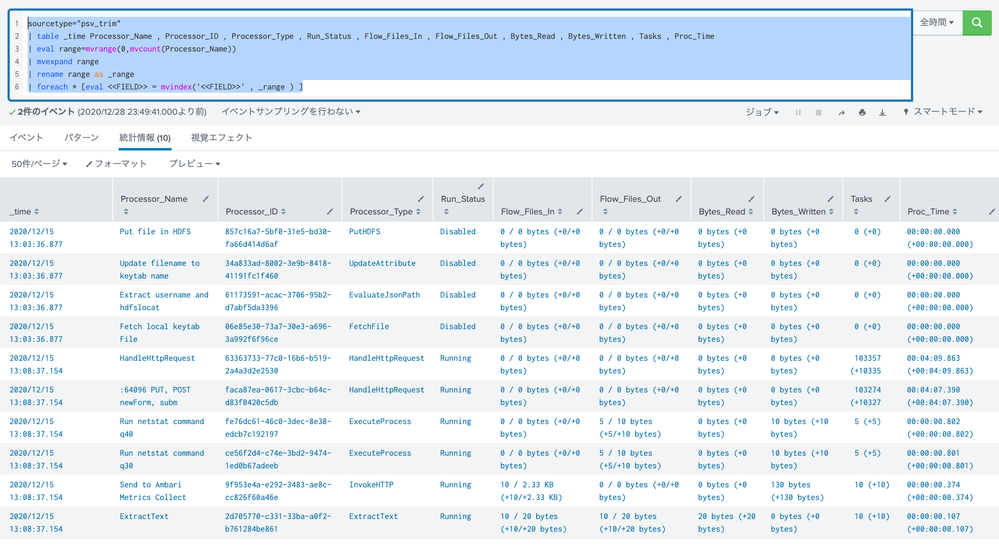

to4kawa
Ultra Champion
sample:
sourcetype="psv_trim"
| table _time Processor_Name , Processor_ID , Processor_Type , Run_Status , Flow_Files_In , Flow_Files_Out , Bytes_Read , Bytes_Written , Tasks , Proc_Time
| eval range=mvrange(0,mvcount(Processor_Name))
| mvexpand range
| rename range as _range
| foreach * [eval <<FIELD>> = mvindex('<<FIELD>>' , _range ) ]
Please make  transforms.conf with my props.conf.
I think your method can't extract _time appropriately.
