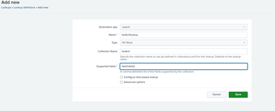

You need to create the lookup definition once you have created the KV Store collection in the lookup editor app.
Go to Settings->Lookups->Lookup Definitions.
Create a new one as below - filling in the relevant details:
Then you should be able to search it using |inputlookup
