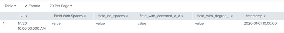

I recently upgraded from Splunk 7.3.2 to Splunk 8.0.5 and I noticed that the newer version does not manage special characters in csv field names.  As a simple exercise I created the following csv saved with Notepad++ wtih UTF-8 encoding:
timestamp;field_no_spaces;Field With Spaces;field_with_accented_a_à;field_with_degree_°
2020-01-01 10:00:00;value;value;value;value
The field names in the header contain characters that are in my source csv: spaces, accented letters and a special character (in this case °).  I followed the import wizard and left default settings in the "Set Source Type" section.  Without making any changes, here is the difference between the versions:
7.3.2
8.0.5
As you can see, 8.0.5 doesn't seem to handle those characters as standard.  I suspect that it might have to do with Python2 in 7.3.2 vs. Python3 in 8.0.5, but I'm not sure what to do.  I browsed the corresponding version of props.conf, but I wasn't able to find anything useful.
Would appreciate if someone could shed some light!  Hopefully someone has faced this issue before me...

Hi,
Did you try setting "HEADER_FIELD_ACCEPTABLE_SPECIAL_CHARACTERS" attribute in props.conf in the [csv] stanza, as per:
https://docs.splunk.com/Documentation/Splunk/8.0.5/Data/Extractfieldsfromfileswithstructureddata

@arowsell_splunk This is exactly what I needed!  I set HEADER_FIELD_ACCEPTABLE_SPECIAL_CHARACTERS in props.conf to "à°" to solve.  Thank you so much!
@manuelostertag I tried the suggestion with the german characters in the field headers and it worked:
updated csv:
timestamp;field_no_spaces;Field With Spaces;field_with_accented_a_à;field_with_degree_°;german_characters_ßäü
2020-01-01 10:00:00;value;value;value;value;value
HEADER_FIELD_ACCEPTABLE_SPECIAL_CHARACTERS = à°ßäü in props.conf
does it not work for you?
