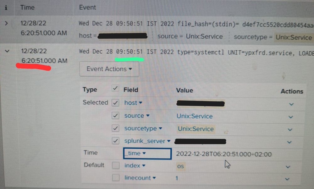

I assume it's caused because of the IST in the event but I don't know how to change it.
wrong time.jpegCan you help?
PickleRick
It seems pretty ok.
The event contains timestamp "9:50:51 IST". It is equivalent to "4:20:51 GMT" or "6:20:51 +2:00".
If the timestamp is wrong, it means your source is reporting wrong time and it's up to the source solution's admin to set the proper timestamp.

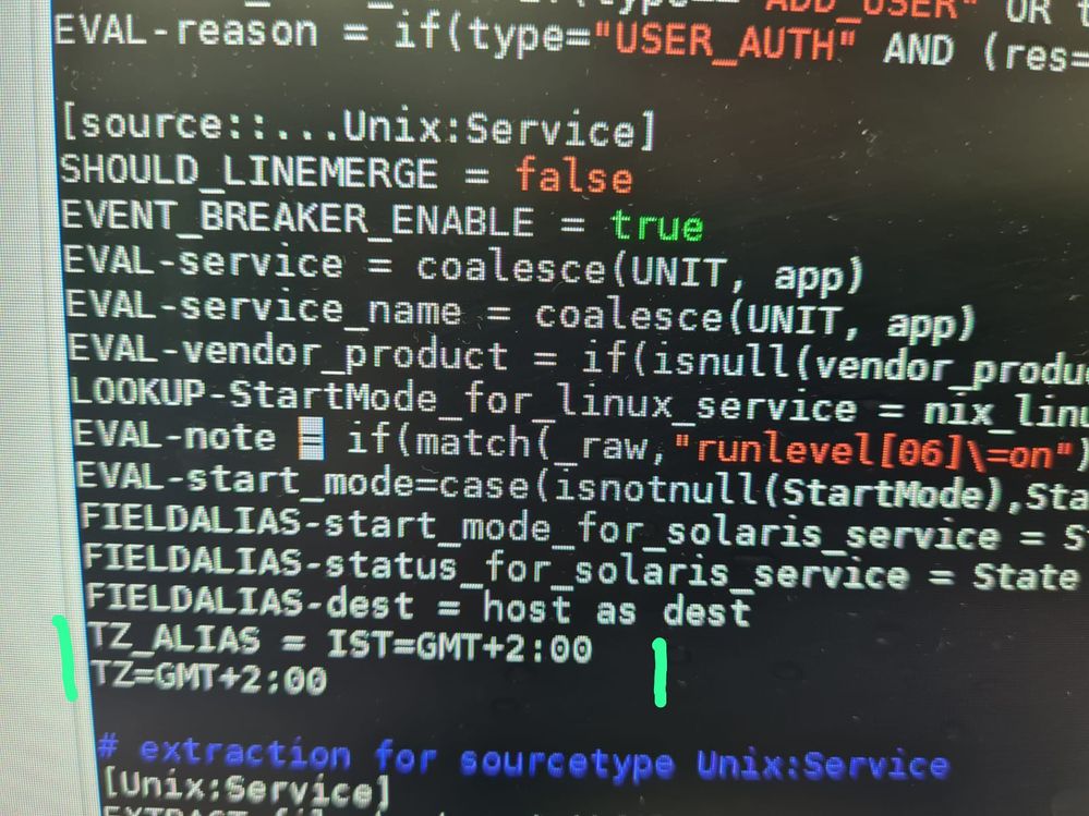

I tried to configure TZ ALIAS in the props.conf but after many syntax tries it looks like it doesn't want to be applied. The props file is in an app which is on my UF's. I restarted the UF's and it still did not work.
What should I do to override the IST in the event?
pictures of props.conf:

Anyway, your idea of TZ_ALIAS is good (don't set TZ for a fixed value - it will break your time in case of daylight saving). But it has to be placed where the timestamp is parsed from the event - indexers or HF if you're parsing on HF. UFs don't parse events (mostly).

The TZ setting is only applied if there is no timezone specified within the timestamp parsed from the event so in your case this setting - even though it is set - will not apply because you have your "IST" in your time string.
Time is generally being parsed on the first "heavy" (based on a full installation, not the universal forwarder binary) component in event's path. So if you're sending your events straight from UF to indexers, the events are parsed on indexers (including timestamp recognition and parsing). If you're sending them from UF to HF(s) which are sending to indexers, parsing is done on HFs. And on those parsing components (in the first case - indexers, in second - on HFs) you need the TZ_ALIAS config.
So if you deploy your config only to UFs, it won't work since UFs don't parse events. They just read/receive them (depending on the type of input) and forward them to indexers/HFs.

I assume it's caused because of the IST in the event but I don't know how to change it. Can you help please?
