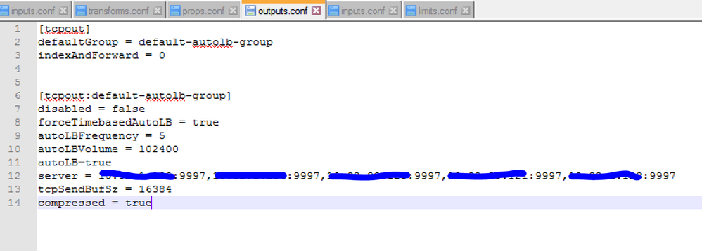

Outputs.conf
There doesnt appear to be any blockage in terms of indexer queues as other events are indexed fine and there is no latency. CPU, Memory and Network is all fine on the virtual machine. I can see no obvious reason why there is a delay.

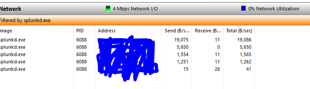

Here is a screenshot from the resouce monitor, network activity.
Slow Windows Event Collector (High Latency)
Fast Windows Event Collector (low latency)
