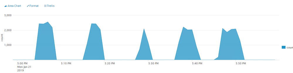

i am using a universal forwarder to monitor and forward data (log file) to my Splunk. i have observed a loss of data...I.e. certain events are missing.
Periodic data loss
What is recommended to avoid any data loss during this period?
is there is any way to acknowledge whether complete data is being sent by the forwarder ??
inventsekar
Hi, the image shows some gaps in logs transmission, because, the UF to indexer can not / need not send logs "all" the times (the logs thruput can vary depending on many factors like network connectivity, how busy the UF/HF/indexers are, etc.. )
may we know how you found out that there are data loss? just by this pic or you really missed logs when you run search queries?!?! is the UF sending lots of logs / how much daily license volume from this UF per day?!?!

Hi,
I checked the log file in the directory of the host installed UF. Some events have not been collected to splunk.
Data generated on UF is very large and continuous. I don't know exactly how much per day.
