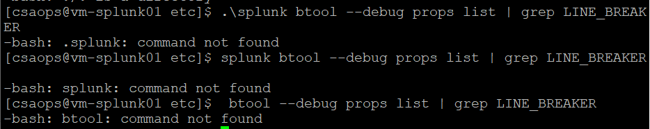

Azwaliyana
Why it said the command not found?
richgalloway
The command "splunk" was not found in your $PATH setting.  Either update $PATH or qualify the command.
export PATH=$PATH:/opt/splunk/bin
/opt/splunk/bin/splunk btool --debug props list | grep LINE_BREAKER
This is not unique to Splunk, but the way the OS works.
