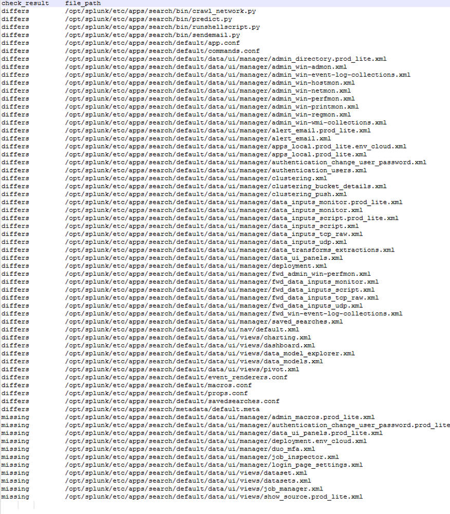

The upgrade process completed without any errors. I then checked the newly implemented health check and the results returned a file integrity warning from our search heads.
The results look like this for every search head we have:
Looking into the actual files on the systems every file is there, even those who are reported missing.
What could be the cause of this?

The file-integrity checks are accomplished by comparing the names, metadata, and checksums of every file that exists in the $SPLUNK_HOME/../splunk-<version>-<FooBarBlahJunk>-<platform>-manifest file for your installed Splunk version against files in $SPLUNK_HOME. You really should only have 1 manifest file in the $SPLUNK_HOME/.. directory, but you probably have many. Delete all of the files that DO NOT match your installed version. Also make sure that the file has permissions that will allow splunkd to read it. If problems persist, I would replace the manifest file with one from another identical server that is NOT having the problem.

I will try that, you are right... there is still the 6.4.1 manifest file.

It kinda fixed it, but there is still one file that is reported to be different.
check_result            file_path
differs         /opt/splunk/etc/apps/search/default/app.conf
Could i edit the manifest file and simply delete the file-checksum at the specific entry?
f 444 splunk splunk splunk/etc/apps/search/default/app.conf 2ee60fc05d6f84344f97a96b2b7ddf166cf3da3626fde8c8b463e5a9470bf574
