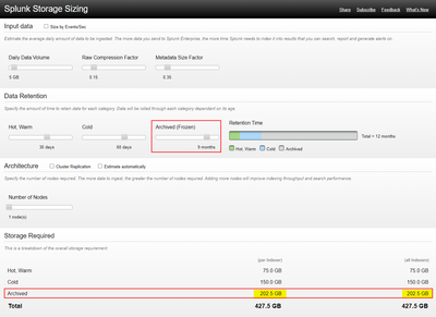

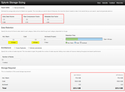

What I have done to validate the calculations is as follows:
For example, I have assumed:
Daily Data Volume = 5GB
Raw Compression Factor = 0.15
Metadata Size Factor = 0.35
Number of Days in Hot/Warm = 30 days
Number of Days in Cold = 60 days
Then for testing, I increased the Archived (Frozen) slider from 0 days to 9 months and then found that the "Archived" storage requirement is now 202.5 GB.
My question is what is the calculation used here to determine the "Archived" storage requirement to be 202.5 GB in this case?

Hi @muradgh,
Frozen path keeps only compressed raw data. That is why the calculation is done using below formula;
DailyDataVolume = 5GB
RawCompressionFactor = 0.15
NumberofDaysinFrozen = 9 months = 270 days
ArchivedStorageSpace = DailyDataVolume* RawCompressionFactor* NumberofDaysinFrozen
ArchivedStorageSpace = 5 * 0.15 * 270 = 202.5 GB
Please keep in mind that Splunk does not manage the Archive path. It just moves raw data to that path.  There is no retention check. This calculation is only for you to provide enough space. You should manually clean data older than 9 months.
