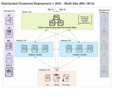

Hi
I have a following architecture and i am trying to setup my Search head cluster .
i have multiple questions ,
if i want to have 1 copy of search artifact in each SH what should be my replication factor here in this command
splunk init shcluster-config -auth <username>:<password> -mgmt_uri <URI>:<management_port> -replication_port <replication_port> -replication_factor <n> -conf_deploy_fetch_url <URL>:<management_port> -secret <security_key> -shcluster_label <label>
Second question is how will i set up the captain in this cluster
If i run this command on the SH1 will it become captain
opt/splunk/bin/splunk bootstrap shcluster-captain -servers_list "https://splunk-essh01.abc.local:8089,https://splunk-essh02.abc.local:8089,https://splunk-essh03.abc...."
Last question is if i want to connect this SHC to the indexer cluster , will this command work
splunk edit cluster-config -mode searchhead -site site0 -manager_uri https:// LB-IP-OR-DNS-HOSTNAME:8089   -replication_port 9887 -secret "<redacted>"

Hi @rahulhari88
To have 1 copy of each search artifact on every search head in your cluster, set the -replication_factor equal to the total number of search heads in your cluster. For example, if you have 3 search heads, use -replication_factor 3.
Example:
splunk init shcluster-config -auth <useername>:<password> -mgmt_uri <yourHost>:8089 -replication_port  -replication_factor 3 -conf_deploy_fetch_url <url>:<port> -secret <secret> -shcluster_label <yourLabel>
To bootstrap the captain, run the splunk bootstrap shcluster-captain command on any one search head (e.g., SH1). The node where you run this command will initially become the captain, but captaincy can change automatically later as this is dynamic (unless otherwise set as static).
Example:
/opt/splunk/bin/splunk bootstrap shcluster-captain -servers_list "https://splunk-essh01.abc.local:8089,https://splunk-essh02.abc.local:8089,https://splunk-essh03.abc.local:8089"
To connect your search head cluster to the indexer cluster, your command is almost correct but you need to specify the site number.
Example:
splunk edit cluster-config -mode searchhead -site site<n> -manager_uri https://yourCMAddress:8089 -replication_port 9887 -secret ""
  • The replication_factor determines how many copies of each search artifact exist in the cluster. Setting it to the number of search heads ensures every SH has a copy.
  • Bootstrapping the captain on any member will make it the initial captain; captaincy may change due to elections.
  • The edit cluster-config command with -mode searchhead is the correct way to connect your SHC to an indexer cluster.

rahulhari88
@livehybrid : the reason for asking 2nd and 3 rd question is in case of 2nd i keep hearing that there needs to be 3 SH in a site in a cluster otherwise captain selection will be difficult , however i can see this architecture as well (https://www.splunk.com/en_us/pdfs/white-paper/splunk-validated-architectures.pdf) ,so is my config correct in that case .
for the 3rd question i have mentioned site as site0 indicating to disable site affinity, is that not correct should i still mention which site it is .

@rahulhari88
Multisite clusters differ from single-site clusters in these key respects:
  1. Each node (master/peer/search head) has an assigned site.
  2. Replication of bucket copies occurs with site-awareness.
  3. Search heads distribute their searches across local peers only, when possible.
  4. Bucket-fixing activities respect site boundaries when applicable
Multisite and single-site nodes share these characteristics:
1. Clusters have three types of nodes: master, peers, and search heads.
2. Each cluster has exactly one master node.
3. The cluster can have any number of peer nodes and search heads.
Multisite nodes differ in these ways:
Every node belongs to a specific site. Physical location typically determines a site. That is, if you want your cluster to span servers in Bangalore and Hyderabad, you assign all nodes in Bangalore  to site1 and all nodes in Hyderabad to site2.
A typical multisite cluster has search heads on each site. This is necessary for search affinity, which increases search efficiency by allowing a search head to access all data locally.

kiran_panchavat
@rahulhari88
The replication_factor determines how many copies of search artifacts (e.g., knowledge objects, search results) are maintained across the search head cluster.
Choose the replication factor for the search head cluster - Splunk Documentation
For example: If you have 3 search heads (SH1, SH2, SH3), set replication_factor to 3. This ensures that every search head maintains a copy of the artifacts.
The command would look like:
/opt/splunk/bin/splunk init shcluster-config -auth admin:<password> -mgmt_uri https://<SH1>:8089 -replication_port 9887 -replication_factor 3 -conf_deploy_fetch_url https://<deployer>:8089 -secret <security_key> -shcluster_label shc1
Captain:
The captain is the search head that coordinates activities in the SHC, such as scheduling searches and replicating artifacts. Running this command on SH1 will designate SH1 as the initial captain. The captain role is dynamic and can move to another search head if the current captain fails, as long as the cluster has a (majority of nodes available).
