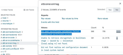

index=_internal  source="/opt/splunk/var/log/splunk/mongod.log"
On my search head cluster peers, they had a very specific error in the field attr.error.errmsg:
(THIS will not show up on other splunk servers, but AS YOU WILL SEE, THIS IS THE ISSUE)
SSL peer certificate validation failed: unsupported certificate purpose

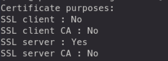

And to check what usages was allowed with my certificates, i ran the following command:
openssl x509 -in <path of my certificate> -noout -purpose
Notice that SSL server is Yes, whereas SSL client is No. Meaning this certificate is not able to be used for client authentication. GOTCHA!!!
So you need to create a new signing request, with an extendedKeyUsage
extendedKeyUsage = serverAuth, clientAuth
However, it is up to the signer to actually respect this request. So I would double check after the CSR has been signed, that it has the correct extended purpose.

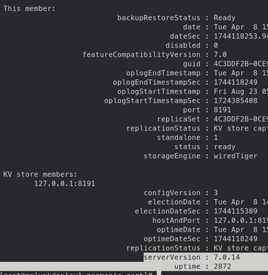

After pushing the new certificate to the server, and restarting Splunk, the kvstore automatically upgraded, and started after ~5 minutes.
I verified using this command:
/opt/splunk/bin/splunk show kvstore-status --verbose
Notice the serverVersion and uptime.
