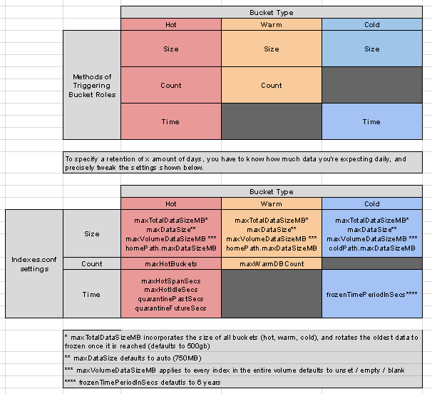

You need a complete understanding of data retention and retirement policies to even understand the answer to your question.
http://docs.splunk.com/Documentation/Splunk/6.5.2/Indexer/Setaretirementandarchivingpolicy
The answer to your question, data age is greater than frozen age possibly because the bucket is still "open".
Such as a hot bucket default size is 10GB for 64bit systems and 750MB for 32bit systems by default. If the data you are adding to the index is much smaller... say 1mb per day, then it would take 10240 days before the HOT bucket closes. In this case Splunk can never roll the hot bucket to warm, and it can not roll from warm to frozen. (Note, Splunk will roll the buckets anytime it stops/restarts)
One way to insure your hot buckets roll is by setting maxHotSpanSecs and maxHotIdleSecs in your indexes.conf:
[indexName]
maxHotSpanSecs = 86401
maxHotIdleSecs = 86401
Thanks to @dwaddle for the reminder. Do not do 86400 or 3600 here as it starts a condition known as ohSnap.
This would cause the hot buckets to roll before reaching their 10gb/750mb limit, and instead they would roll every 86400s (1 day). Another event that will trigger hot bucket rolls is restarting splunk on the indexer.
You can also set the maxDataSize to smaller numbers which will cause them to roll sooner, but generally you end up with a combination of indexes.conf settings when you're trying to set a very specific retention period.
