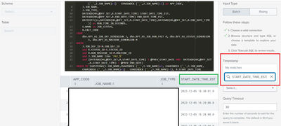

Hi, we are trying to configure a MSSQL query in DB Connect App. Some how we are not be able to select timestamp field.
Field is present in output results. Any idea what could be issue.
Query:
use XXXXX
DECLARE @OFF_SET NUMERIC(1), @PREV_START_DATE VARCHAR(21), @PREV_END_DATE VARCHAR(21)
SET @OFF_SET = (select DATEDIFF(HH, GETUTCDATE(), GETDATE()))
SET @PREV_START_DATE = (SELECT CONVERT(VARCHAR(11),DATEADD(d,-1,DATEADD(dd, DATEDIFF(d,0,GETDATE()), 0)),106)+' 00:00:00')
SET @PREV_END_DATE = (SELECT CONVERT(VARCHAR(11),DATEADD(d,-1,DATEADD(dd, DATEDIFF(d,0,GETDATE()),0)),106)+' 23:59:59')

AKG11
I have simplified my query. removed the first command " use  <DB>" as its not needed. you can define the db and table from dropdown.

Hello @AKG11  ,  we are facing a similar issue, and trying to get data via a Stored procedure, as below, but not able to select the date column for choosing the _time. Any ideas please ?
DECLARE @From_DT DATE, @To_DT DATE;
SET @From_DT =xxx
SET @To_DT = xxx
exec 'storedprocedure_name' @From_DT, @To_DT;

We are encountering this issue too. Did you find a solution @AKG11 ?
AKG11
