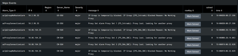

So I am using this script , what this script does it it creates a solved button on each field of dashboard drilldown and when that button it clicked it changes the value of solved field to 1 from 0 . I wan to know whats wrong in this script button can be seen but when it is clicked nothing happens even if i refresh the drilldown.
This is the drilldown with the button in rowKey field.
This is the script.

Hi @SN1
I would start by adding a console.log(rowKey); and also one after searchQuery - console.log(searchQuery);
and then validate that these are outputting what you expect.
Can you check to see if this prints out what you are expecting and let us know how you get on as this might help drill down further.
