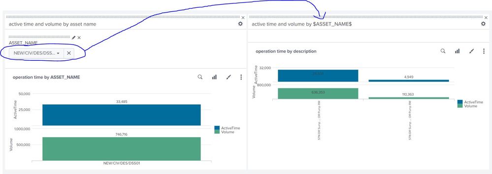

Hi i would like to check is there a way to hide my chart before i select my ASSET_NAME from the dropdown box, example the picture below is my initial startup dashboard but the chart on my right does not make sense only after i select any of my chart on the left then the right chart will make sense so my question is there a way to mask of the initial search?
if ASSET_NAME : ALL is selected my chart on the right should be blank .
problem 1.JPG, if there is other selection it will show the result problem 2.JPG
thanks

@chookp add the following to your dropdown change event handler to set/unset showPanel2 token and use the token as depends attribute for Panel 2 <panel> as well as <search>
        <change>
          <condition label="All">
            <unset token="showPanel2"></unset>
          </condition>
          <condition>
            <set token="showPanel2">true</set>
          </condition>
        </change>
    <panel depends="$showPanel2$">
      <table>
        <title>Panel 2</title>
        <search depends="$showPanel2$">
Following is a run anywhere dashboard example based on the details provided for you to try and confirm!

Just add the following to the XML in the panel definition for the one you want to hide
<panel depends="$ASSET_NAME$">
 The the XML ref guide for the depends attribute
https://docs.splunk.com/Documentation/Splunk/8.0.4/Viz/PanelreferenceforSimplifiedXML#panel
