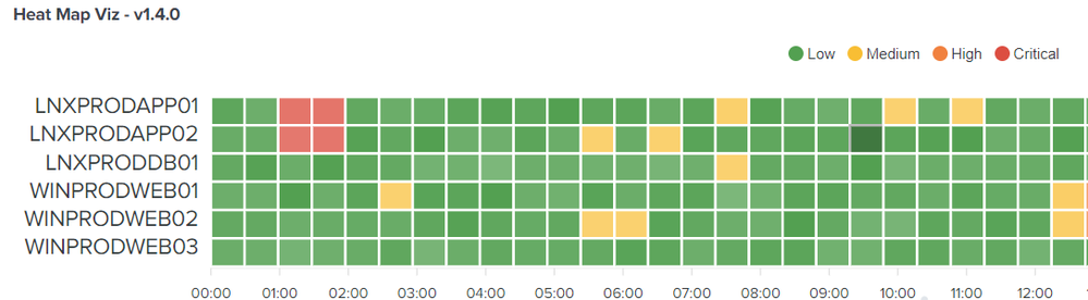

hi
i need to do an heat map vizualization
i have checked the dasbord examples addon and in this example a lookup is used
 | inputlookup sample-data.csv
is it possible to do the same thing without a lookup please? I mean by using an index and an eval command
for example if the field "Value" is < 50 th color is green, <30, the color is orange and < 10 the color is red in my heat map
Rgds

Not sure you understand my needs In the example below you can see thats random numbers are displayed | gentimes start=-10 increment=4h | eval "Server Availability"=random()%100, "Customer Satisfaction"=random()%100,"Server Performance"=random()%100, _time=starttime | table _time, "Server Availability","Customer Satisfaction","Server Performance" Instead random numbers, i would like to have true numbers froms my index, for example from the field "Value" so i dont know how to query on it in the example i gave to you

its what I am doing but it returns no heat map
index="main" sourcetype="Perfmon:disk"
| eval _time=strptime(time, "%m/%d/%Y %H:%M")
| timechart eval(round(avg(Value),0)) by host
instead this which returns an heat map
| timechart eval(round(avg(value),0)) by name

now it works...
Last question : how to change the rangemap of the colors
It iis in the xml or is it automatic?
