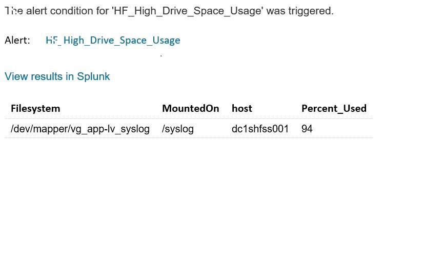

Mean while I got a message from splunk which states that HF disk space is getting full.
