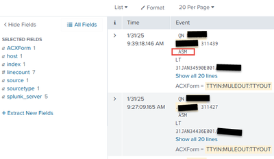

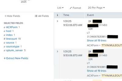

Here is the events from left to right for the 3 panels.
So here the DR1 is not showing but the 1st and 3rd panels work but the middle one does not.  The characters in the RED box is what the DR1 is looking for either SSM or ASM
