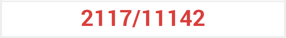

I would like to show something like that :
59/45
And color result with result of division :

I want to see result (in field) and color of value with percent.
I try with the option "field" but if I select result, I see the result without color.
Any ideas ?

4 - Ok for replace.... But it doesn't work...
=> Finally it works. I must remove rangeColors and rangeValues for the good result.
