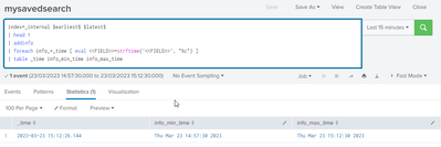

Yes, you can use the savedsearch command and pass it the earliest and latest times as replaced field values.  Here's the doc ref.
https://docs.splunk.com/Documentation/SplunkCloud/latest/SearchReference/Savedsearch
As an example
1. Create a saved search (report)
index=_internal $earliest$ $latest$
| head 1
| addinfo
| foreach info_*_time [ eval <<FIELD>>=strftime('<<FIELD>>', "%c") ]
| table _time info_min_time info_max_time
2. Now run the report using the savedsearch command, passing in the earliest and latest variables as time modifiers (you can name these variables to whatever you like)
Note, the dashboard XML for the search would need to be something like this
<search>
  <query>| savedsearch mysavedsearch earliest="earliest=-24h@h" latest="latest=-1m@m"</query>
</search>
Hope this helps.
