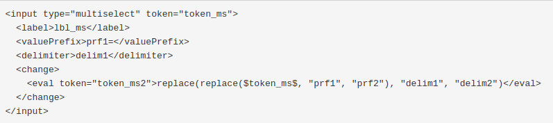

On the dashboard, I use 2 multiselect with the same values, but with different parameters delimiter and prefix. Is it possible to use one multiselect to create two variables with different values of delimiter and prefix. If so, how?
nryabykh
Hi!
You can try the following workaround:
(sorry for image, but I have some problems with correct insertion a block of XML here)
The point is to eval new token in change block of multiselect input:
<eval token="token_ms2">replace(replace($token_ms$, "prf1", "prf2"), "delim1", "delim2")</eval>
where prf1 is the prefix in multiselect and delim is the delimiter.
nryabykh
Hi!
