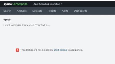

@ITWhisperer  I am trying to add Italics to the description tag
<dashboard>
  <label>test</label>
  <description>I want to italicize this text ---&gt; This Text &lt;-----</description>
</dashboard>
ITWhisperer
You can make the whole description italics
    <panel depends="$stayhidden$">
      <html>
        <style>
          p.description {
            font-style: italic;
        </style>
      </html>
    </panel>
but possibly not part of the element
Or, you could just add a block of html
  <row>
    <html>
      This line contains some <span style="font-style: italic;">italic text</span> in the middle
    </html>
  </row>
