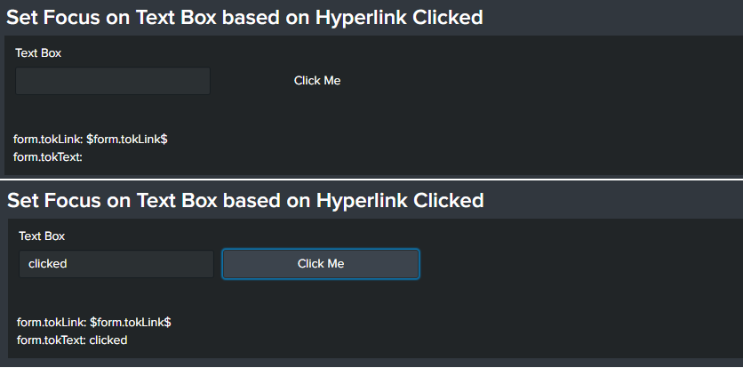

@nick405060 please add more details on the Text Box and HyperLink. Is it Splunk Text box input? Also is the Hyper Link Splunk's Link input or something else?
If the hyperlink is HTML element link anchor tag, you would need to know jQuery and SplunkJS Stack to pass on the token value. Refer to Splunk Blog by @Jconger on using HTML5 inputs in Splunk dashboard using Simple XML JS extension: https://www.splunk.com/blog/2016/09/21/using-html5-input-types-on-splunk-forms.html
If they are both Splunk inputs then you can try the following run anywhere example in Simple XML. PS: Dont bother about the Dark Theme, I was trying out 7.2 ;). Simple XML code does not have Splunk Enterprise 7.2 dark theme dependency, as I have removed theme="dark" from the root <form> node.
Following is the Simple XML code for run anywhere example in the screenshot above. On click of Click Me link the Text Box value is changed to clicked
<form>
  <label>Set Focus on Text Box based on Hyperlink Clicked</label>
  <fieldset submitButton="false"></fieldset>
  <row>
    <panel>
      <input type="text" token="tokText" searchWhenChanged="false">
        <label>Text Box</label>
      </input>
      <input type="link" token="tokLink" searchWhenChanged="true">
        <label></label>
        <choice value="clicked">Click Me</choice>
        <change>
          <condition value="clicked">
            <set token="form.tokText">$value$</set>
            <unset token="form.tokLink"></unset>
          </condition>
        </change>
      </input>
      <html>
        <div>form.tokLink: $form.tokLink$</div>
        <div>form.tokText: $form.tokText$</div>
      </html>
    </panel>
  </row>
</form>
