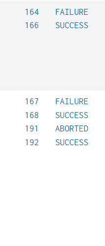

2022-03-04_10h23_44.pnghi, I have one doubt. My data has some URL s which have status as "ABORTED". While grouping this will also be grouped. How to avoid this? I only want to group the FAIL URL with its immediate next PASS URL.   and it is listing the FAIL also even when there is no next PASS URL. How to avoid this?@ITWhisperer
ITWhisperer
| where status!="ABORTED"
| streamstats count as start reset_on_change=true by status
| where start=1
| streamstats count(eval(status=="FAILURE")) as fails by status
| eval fails=if(fails=0,null(),fails)
| filldown fails
| stats list(*) as * by fails

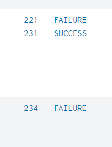

2022-03-04_13h18_07.pngYes i got it. Is it possible to avoid the FAIL coming individually?There are no PASS URLs after that but it is still coming like that. Is there any way. I tried and i was not able to remove that.
ITWhisperer
| where mvcount(status) = 2
