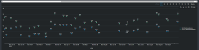

I want to generate a time chart that shows time on x-axis, results on y-axis and hue (legend) showing the different analytes. So far this what I have generated which is not the format I am looking for. I have the search code below. I probably do not need fieldformat but was thinking I needed the correct datatype. I am used to python Jupyter notebooks and am quite new to Splunk. Any help would be very appreciated. For example, I am showing a scatter plot from python that I can generate that mirrors what I am looking for in Splunk
Incorrect Splunk Scatter PlotIncorrect Splunk Scatter PlotExample of What I want to get toExample of What I want to get to

You can't do time on x-axis on a scatter plot, so the best way to do this is with a timechart and a bit of trickery with the data
Note you can do all your search statements in a single search command

In the timechart, set the handling of null values to gaps.
See this post
https://community.splunk.com/t5/Splunk-Search/Scatter-Plot-for-time-x-axis-and-numbered-Y-axis/m-p/3...

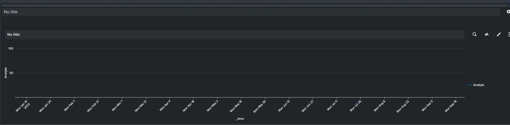

Thanks for your help and the suggestion group search statements in single command that is very useful.  I followed your suggestion and still am not getting a plot.  Does this work with scatter plot or only line plot as I went to link you tagged and from there it stated to use line plot.  Here is the code below and snips of what I am seeing.
|inputlookup $lookupToken$
|where _time <= $tokLatestTime$ AND _time >= $tokEarliestTime$
|search $lab_token$ $analyte_token$ $location_token
|replace "ND" WITH 0 IN Results
|timechart max(Results) as Results by Analyte
|append [
  |search $lab_token$ $analyte_token$ $location_token$
  |bin _time span=1d
  |stats max(Results) as Results by _time Analyte
  |eval Results=null()
|sort _time
|fields - Results
Scatter Plot w/ suggested codeScatter Plot w/ suggested codeLine Plot w/ suggested codeLine Plot w/ suggested code
Now if I remove the Results=null(), remove replacing ND with 0 and switch fields to Analyte instead of Results I get points again and something close to what I want but still off a bit.  I am hoping to see the analytes on the legend.  You have any further suggestions?  I feel I am close.

Scatter plot still is blankScatter plot still is blankLine Plot is close but still missing analyte namesLine Plot is close but still missing analyte names
bowesmana
It must be done with a line chart, not scatter, as scatter will not handle time on the x-axis.
Can you post an example of what the data looks like
I would expect a series of rows with a _time column followed by a column for each Analyte and then the Result value in each cell for the _time/Analyte.

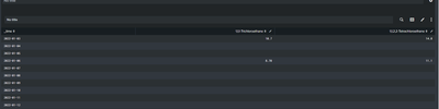

Not sure what happened, but logged in over the weekend and somehow I have what I want lol.  Was getting frustrated on Thursday and have up but must have done something right.  Here is the code... and image of graph and table.  Thanks for all your help!!!
            |where _time >= $tokEarliestTime$
            |search $lab_token$
            |search $analyte_token$
            |search $location_token$
            |sort _time desc
            |fieldformat _time=strftime(_time, "%Y-%m-%d")
            |table Analyte, _time, Results
            |timechart span=1d max(Results) by Analyte
            |eval Results=null()
