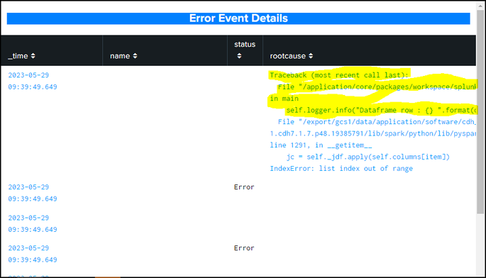

Please help us on the dashboard issue, we have a splunk xml dashboard table as shown in the below snippet.
In the root cause column the entire event is coming . We need help so that the entire event should be adjusted to 4 lines and if required the column width can extend as per the event.

Here I suggest displaying the trimmed value in table view and displaying the full value by expanding the table row.
This is a sample search for trimming value.
| makeresults | eval A="a
b
c
d
e
f
g
h
| rex field=A "(?<displayA>^.*\n.*\n.*\n.\n)"
 And this is an example of "How to use Row expansion"
https://community.splunk.com/t5/Dashboards-Visualizations/Receiving-quot-A-custom-JavaScript-error-c...
Let me know if you need more help on this.
