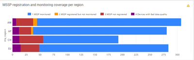

Screenshot for Reference:
The above is an example of horizontal but I am looking for vertical.

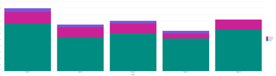

Current situation:-
Thanks in advance!

bowesmana
The fact that you have Rag_Status and count in your legend would indicate you have done a stats count, not a chart count.
See the difference of the tabled output between using this
| makeresults count=200
| eval KPI_Score=random() % 100, KPI_Threshold=80, SWC="SWC:".(random() % 5)
| eval RAG_Status = case(
KPI_Score >= KPI_Threshold, "Green",
KPI_Score >= (KPI_Threshold - 5), "Amber",
KPI_Score < (KPI_Threshold - 5), "Red"
| chart count BY SWC RAG_Status
| sort SWC
and then using stats rather than chart in the second line.
In the chart case, you should end up with columns SWC and then Amber, Green and Red, but if you use stats, you will get SWS, RAG_Status and count. In the first case you can stack the data perfectly OK

varma364
Yes, thank you @bowesmana
