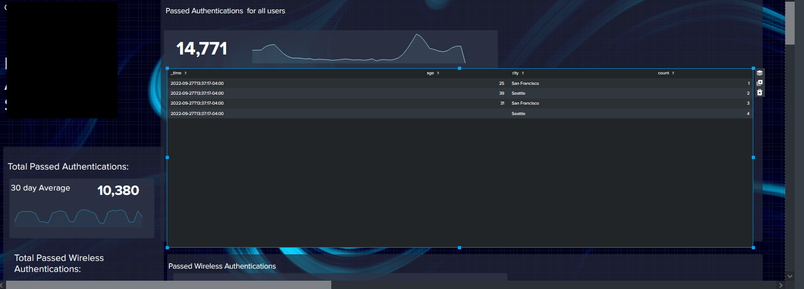

I'm having the same issue working in Dashboard studio, I am trying to increase the font size of the records in the table .
I added the "fontSize" Attribute to the table.
And like the suggestions above the Layout is absolute.
Below are the screenshots of the code.
Any suggestions on how to increase the font size?
