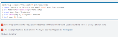

Your query gives the following error though:
Here is the query in writing too:
(index=mwg sourcetype=MWGaccess3) OR index=solarwinds
| lookup Cybersecurity_Infrastructure NodeID OUTPUT Asset_State NodeName
| eval NodeName=lower(coalesce(NodeName,host))
| search Asset_State="Production"
| stats values(Region) AS Region BY NodeName
| top 5 count BY Region

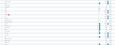

Without the Top command, I receive the following with no category values:
This is strange as if I run the query just as a search, I get data with both the Region and category fields I need:
and:
It is when I add extra commands like top or stats onto this data that it seems to not read the Region or category fields. Like in this case, where it gives no category values:
