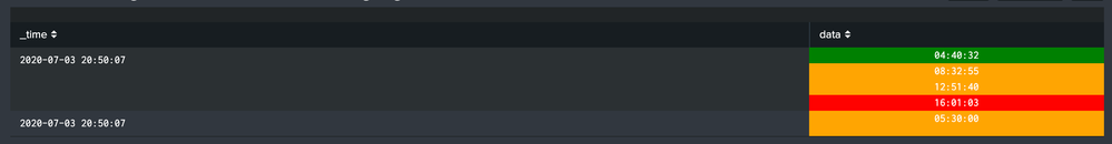

@richielynch89 can you try the following updated JS and confirm?

 While selecting the Table Cell I have added condition for td  being highlighted if it is not a multi-value field. (Assuming multivalue cell will have length >8 because of multiple HH:MM:SS format.)
Also replace Existing Simple XML CSS override with the following:
      <html>
        <style>
          #highlight td[data-cell-index="1"]{
            padding: 0px;
            text-align: center;
        </style>
      </html>
