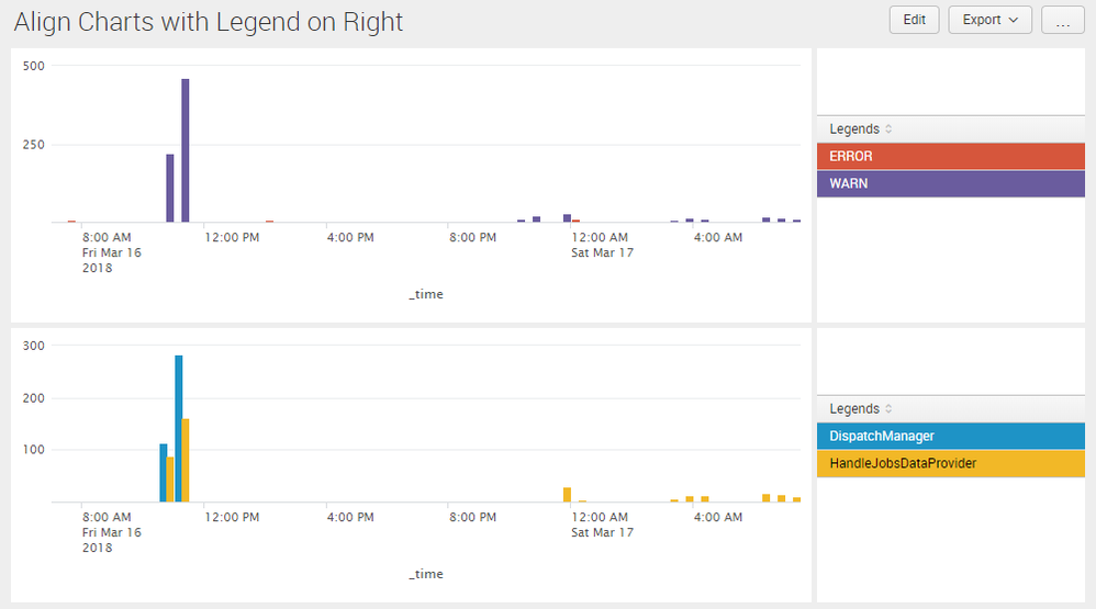

niketn
Legend
@jeffland, since the Splunk chart is heavily built with SVG and all the components adjust dynamically based on values of other components. Hence, messing around with various components of the chart without impacting others is nearly impossible unless done from code.
See if following workaround fits the need.
  1. Hide Legends on Charts.
  2. Give ids to chart search queries for post processing.
  3. Give Panels ids.
  4. Add a panel with table in each row. Give tables ids.
  5. Use the chart queries in table through post processing and perform transpose to get the Legend names.
  6. Format Table Legend column in Edit mode and Color by Values with Automatic option (this applies similar colors as Series Color. If you have Field Colors applied for your chart instead of default/manual Series Colors then you will have to use Define Rules instead of Automatic.)
  7. Use ids for Panel to adjust width of panels using CSS Override like 75% for chart & 25% for Legend
  8. Use table ids to add padding/margin on top of the table using CSS Override (this is to bring legends to the center. PS: Other formatting can also be applied on Legends table through CSS Override like Hide the Legend Table Header, Center Text etc.

lakromani
Builder
Problem with this is that you can not holde the mouse over a legend so that its data get highlighted.
It becomes separated data.

jeffland
That might help with the differently sized legends, but it doesn't with the axis labels. At any rate, it changes how the entire dashboard looks, and I would prefer if the legend stayed to the right of the charts - just with an adjustable width.
