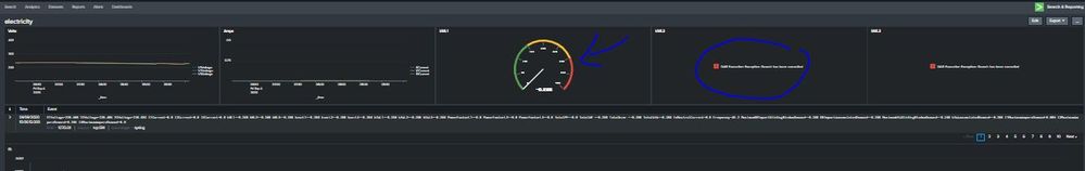

Hi,
Every few minutes the dashboard shows me this error:
Dag Execution Exception: Search has been cancelled. Search auto-canceled.
I tried to change the dispatch.auto_cancel = 0, but the error returned.
Please help me find the solution for this error.
If it helps, this search is 30 seconds real time, and 1 min refresh.
Thanks.

i Understand that the problem is in the realtime search.
i change one of the dashboard gauge to 2 sec (not realtime) and the Execution  not shown on it.
but steel realtime is problem.
thanks
