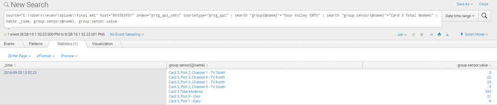

I am trying to exclude results from a set of data from an XML data source.
I can search for events containing the particular string but when I change the search to "does not equal" it will return no results at all.
In this example, I want to exclude "Card 3 Total Modems" but Splunk will show no results if I change it or by clicking on the field and selecting "exclude results."
source="C:\\Users\\evanr\\splunk\final.xml" host="OSSTEST01" index="prtg_api_cmts" sourcetype="prtg_api" | search "group{@name}"="Twin Valley CMTS" | table _time, group{@name}, group.sensor{@name}, group.sensor.value

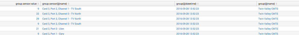

Hi,
Sorry for the delay, can you give this a go a let me know if this is what you are looking for?
Assumptions:
  1. Your event has a _raw field with all the XML data in there
  2. You want to filter group name = "Twin Valley CMTS" but if not simply apply the same logic as below
  3. You don't want to see "Card 3 Total Modems" but if not simply modify the filter below
  4. If you want to summarise the final output into values simply use stats values(fieldname) as fieldname to do that
Query:
your base search here
| rex field=_raw "(?msi)(?<group>\<group name=\"Twin Valley CMTS\".+?\</group\>")
| spath input=group
| eval temp = mvzip('group.sensor{@name}', 'group.sensor.value', " <--> ")
| fields - "group.sensor{@name}", "group.sensor.value"
| mvexpand temp
| search temp != "Card 3 Total Modems*"
| rex field=temp "(?<name>.+) \<--\> (?<value>.+)"
| rename name as "group.sensor{@name}", value as "group.sensor.value"
| fields - temp, group, _raw
When I tried this with the sample you attached last week this is what I got (see picture below):

On the image, you are searching for Card 3 Total modems and it is returning only one event. so, if you want to remove that line "Card 3 total modems", the search won't return any events.
I think it's due to the source XML and the line breaking.
May I know, how many events are returned by this query -
source="C:\Users\evanr\splunk\final.xml" host="OSSTEST01" index="prtg_api_cmts" sourcetype="prtg_api" | search "group{@name}"="Twin Valley CMTS" | table _time, group{@name}, group.sensor{@name}, group.sensor.value

evan_roggenkamp
This returns essentially one event, with all of the groups included. It looks exactly like the image above.
Here is the neat thing - this XML file I created with python. So if there is some better way of formatting/structuring the source XML to increase the flexibility I have in Splunk to filter it, I can do that. It is just a matter of updating the python code.
Do you have any recommendations?
