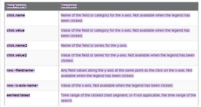

https://docs.splunk.com/Documentation/Splunk/latest/Viz/EventHandlerReference#chart_.28event_tokens.....
Depending on if you want the X or Y axis value, you'll want to use tokens from above reference.

Hello @jkat54,
Thank you for your inputs.
I referred to below list but it didn't help to get the result: -
