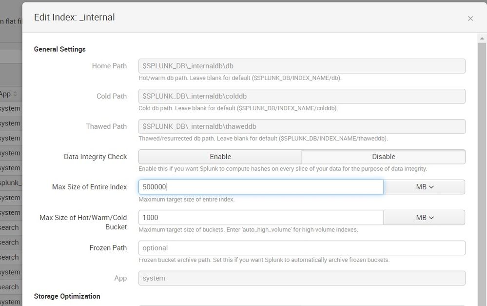

what't the default size of _internal index:
  • 5 GB
  • 10 GB
  • 20 GB
  • 30 GB
I'm working on Splunk from 8 years and I didn't find any special default size for this index (except the normal size of 500 GB of all indexes).
Anyone can say to me where can I find this dimension (if exists)?
Thank you.
Giuseppe

The question is tricky , I did try to make some sense of it from my local. I may (most probably will be) wrong.
As you say there is a max size of the entire index(and all indexes) in general that can go up to 500 GB. That is more like an upper limit perhaps?
Below that is given max size of hot/warm/cold bucket ~ 1 GB each. Now, if the buckets were created with the deafult max size of 1 gb each and assuming we include 5 buckets hot,warm,cold,frozen and thawed it would perhaps be 5 gb in total.
There is a separate path for thawed db and an optional path for frozen as well in the same settings screen shot.
If you refer this - https://docs.splunk.com/Documentation/Splunk/7.3.1/Indexer/HowSplunkstoresindexes#Bucket_names
and see the section 'how data ages'

They talk about 5 buckets and assuming that they already come with some default size(the max size per bucket) it could be 5 gb . answer#1.
It does also say that frozen buckets are deleted by default unless they are archived so I am not all sure!
I am just perhaps trying to force fit an answer given the options that you mentioned...
or could it be a typo in the question from the exam itself!!?
Sorry, if you had already considered these options and decided that they were incorrect.

Your interpretation could be correct and your answer only confirms what I thought: there isn't a precise point in which documentation says exactly what is the default value for the _internal index!

studying for the exam, I found this information at https://docs.splunk.com/Documentation/Splunk/7.3.1/Troubleshooting/WhatSplunklogsaboutitself
If you have any long-running real-time searches, you might want to adjust the maximum size of your search logs. These logs are rotated when they reach a default maximum size of 10 MB. Splunk software keeps up to five of them for each search, so the total log size for a search can conceivably grow as large as 30 MB.
do you think that this could be the exact answer?
Bye.
Giuseppe

this certainly matches the answer options, but I am not feeling sure, the section you cited begins with
The Splunk platform also creates search logs. These are not indexed to _internal.
So, is this specific to _internal index?
Wondering if someone from splunk in the forum can clear this for once and for all?

looks like it @gcusello ...but I agree with @woodcock I understand that there will be some straight knowledge questions , but this one is..well just too much 'nitty-gritty'

It must be but again, it is a silly thing to test about.
