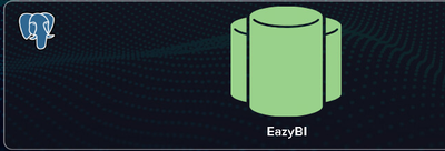

I need some help adding colour to my dashboard. I've got the below block sitting on my high level dashboard view, but I want it to change colour (Red or Green) dependent on the values of the underlying dashboard that it clicks through to which I will share below.

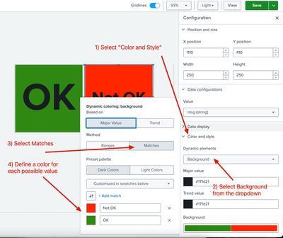

Hi @sufs2000
Have a look at the image below, does this help you work out the settings required to have colour dependant on the value?
Please let me know how you get on and consider adding karma to this or any other answer if it has helped.

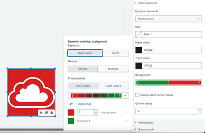

I see, sorry I misread the first question. In that case I think you would need to use a search which will determine if either of the lower-level dashboard entities are not "OK" , are you comfortable creating this search?

Ultimately using an IF to determine if its bad (and set value to 1) then sum up the isBad field to get a single value for if there is an issue (>=1)
| eval isBad=IF(status!="OK",1,0)
| stats sum(isBad) as isBad
Once that is done you can apply the same type of logic (see below)
