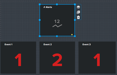

I just started with splunk. Currently I'm testing the new dashboard studio feature.
I would like to count all searches with 1 or more found events on my dashboard.
In case of the attached picture, I would like to display 3 in the upper SingleValue field. If the search for Event 2 has 0 results, i would like to display a 2, and so on.
Is there a simple and scalable solution to this, if I want to add more searches to the dashboard later on?

Coffeebean
@jhanvidattani
Thanks for the answer, but that looks like a XML solution.
As i tried this method with Dashboard Studio, which doesn't support XML, this will probably not work.
I will try to redesign my project with the old Dashboard builder.
MMahlberg
Sure, it can be done but you have to do it in one query and then select the fields in the field selector. Try this:
    "visualizations": {
        "viz_L1aSlLpB": {
            "type""splunk.singlevalue",
            "dataSources": {
                "primary""ds_HbMCf42K"
            "title""field1"
        "viz_gpsfTDga": {
            "options": {
                "majorValue""> sparklineValues | lastPoint()",
                "trendValue""> sparklineValues | delta(-2)",
                "sparklineValues""> primary | seriesByName('field3')"
            "dataSources": {
                "primary""ds_HOFmRc1r_ds_HbMCf42K"
            "title""field3"
        "viz_gAmWIokL": {
            "options": {
                "sparklineValues""> primary | seriesByName('field2')"
            "dataSources": {
                "primary""ds_Epg28xu5_ds_HOFmRc1r_ds_HbMCf42K"
            "title""field2"
        "viz_3gzCc3Pv": {
            "options": {
                "sparklineValues""> primary | seriesByName('Total')"
            "dataSources": {
                "primary""ds_WVxE4sTM_ds_HOFmRc1r_ds_HbMCf42K"
            "title""total"
    "dataSources": {
        "ds_HbMCf42K": {
            "type""ds.search",
            "options": {
                "query""| makeresults\n| fields - _time\n| eval field1= 1\n| eval field2= 2\n| eval field3= 3\n| addtotals"
            "name""Search_1"
        "ds_HOFmRc1r_ds_HbMCf42K": {
            "type""ds.search",
            "options": {
            "name""Copy of Search_1"
        "ds_Epg28xu5_ds_HOFmRc1r_ds_HbMCf42K": {
            "type""ds.search",
            "options": {
            "name""Copy of Copy of Search_1"
        "ds_WVxE4sTM_ds_HOFmRc1r_ds_HbMCf42K": {
            "type""ds.search",
            "options": {
        "ds_6sMlf8EL_ds_Epg28xu5_ds_HOFmRc1r_ds_HbMCf42K": {
            "type""ds.search",
            "options": {
            "name""Copy of Copy of Copy of Search_1"
    "defaults": {
        "dataSources": {
            "ds.search": {
                "options": {
                    "queryParameters": {
                        "latest""$global_time.latest$",
                        "earliest""$global_time.earliest$"
    "inputs": {
        "input_global_trp": {
            "type""input.timerange",
            "options": {
                "token""global_time",
                "defaultValue""-24h@h,now"
            "title""Globale Zeitspanne"
    "layout": {
        "type""absolute",
        "options": {
            "display""auto-scale"
        "structure": [
                "item""viz_L1aSlLpB",
                "type""block",
                "position": {
                    "x"120,
                    "y"160,
                    "w"200,
                    "h"130
                "item""viz_gpsfTDga",
                "type""block",
                "position": {
                    "x"550,
                    "y"160,
                    "w"200,
                    "h"130
                "item""viz_gAmWIokL",
                "type""block",
                "position": {
                    "x"340,
                    "y"160,
                    "w"200,
                    "h"130
                "item""viz_3gzCc3Pv",
                "type""block",
                "position": {
                    "x"340,
                    "y"10,
                    "w"200,
                    "h"130
        "globalInputs": [
            "input_global_trp"
    "description""",
    "title""test"
