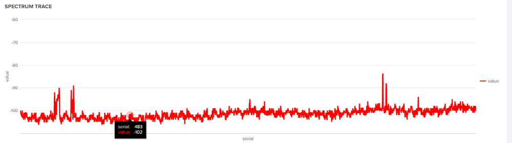

hi
my dashboard plot event by time. i change the time to look like serial (see image) and i plot 2001 events.
i want to paint by time, for example:
serial 0-199 red.
200-1000 blue.
1001 2001 green.
my search code:
source="tcp:514"
| streamstats values(_raw) as value
| makemv value
| mvexpand value
| search value<0
| streamstats count AS _time
| rename _time AS serial
| table  serial value | head 2001
my plot:
thanks

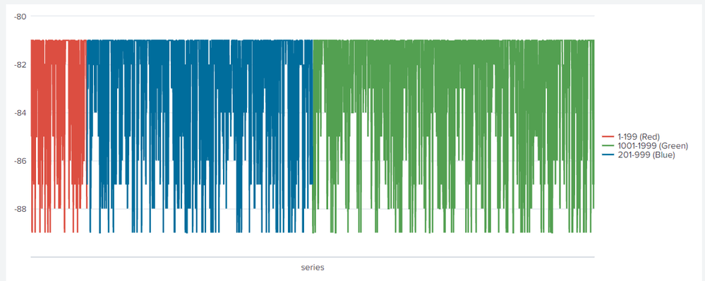

However, answering to your original question since you have to color the series based on sequence, try the following run anywhere example which generate 2000 negative values between -80 to -89 and then applied field color by creating series for 1-200, 201-1000 and 1001-2000 as Red, Blue and Green respectively.
Following is the Simple XML code for run anywhere example.
<dashboard>
  <label>Chart with Color based on Sequence</label>
  <row>
    <panel>
      <chart>
        <search>
          <query>| makeresults count=2000
| fields - _time
| streamstats count AS series
| eval series=printf("%05d",series)
| eval value=random(), value="-8".substr(value,1,1)
| eval series1=case(series>=1 AND series<200,"1-199 (Red)",
    series>=201 AND series<1000,"201-999 (Blue)",
    series>=1001 AND series<2000,"1001-1999 (Green)")
| xyseries series series1 value</query>
          <earliest>-24h@h</earliest>
          <latest>now</latest>
          <sampleRatio>1</sampleRatio>
        </search>
        <option name="charting.fieldColors">{"1-199 (Red)":0xDC4E41,"201-999 (Blue)":0x006D9C,"1001-1999 (Green)":0x53A051}</option>

erez10121012
thanks @niketnilay it works 🙂
source="tcp:514"
    | makemv value
    | mvexpand value
    | search value&lt;0
    | rename _time AS series | fields - _time
    | eval series1=case(
    series&gt;=0 AND series&lt;130,"Anomaly (Black)",
    series&gt;=131 AND series&lt;250,"Cell (Blue)",
    series&gt;=250 AND series&lt;999,"Anomaly (Black)",
    series&gt;=1000 AND series&lt;1100,"Cell (Green)",
    series&gt;=1101 AND series&lt;1499,"Anomaly (Black)",
    series&gt;=1550 AND series&lt;1650,"WIFI (Red)",
    series&gt;=1651 AND series&lt;2001,"Anomaly (Black)")
    | xyseries series series1 value| head 2001</query>
