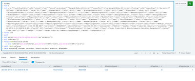

From your original search you should be able to do:
| eval params=json_array_to_mv(json_extract(_raw,"parameters"))
| eval newParams="{}"
| foreach mode=multivalue params
    [| eval newParams=json_set(newParams,json_extract(<<ITEM>>,"name"),json_extract(<<ITEM>>,"value"))]
| spath input=newParams
| table accessDate, userName, serverHost, @SparklingTypeId, @PageSize, @PageNumber
Below is a full example to get you started:
| windbag
| head 1
| eval _raw="{\"auditResultSets\":null,\"schema\":\"com\",\"storedProcedureName\":\"SpongeGetBySearchCriteria\",\"commandText\":\"com.SpongeGetBySearchCriteria\",\"Locking\":null,\"commandType\":4,\"parameters\":[{\"name\":\"@RETURN_VALUE\",\"value\":0},{\"name\":\"@SpongeTypeId\",\"value\":null},{\"name\":\"@CustomerNameStartWith\",\"value\":null},{\"name\":\"@IsAssigned\",\"value\":null},{\"name\":\"@IsAssignedToIdIsNULL\",\"value\":false},{\"name\":\"@SpongeStatusIdsCSV\",\"value\":\",1,\"},{\"name\":\"@RequestingValueId\",\"value\":null},{\"name\":\"@RequestingStaffId\",\"value\":null},{\"name\":\"@IsParamOther\",\"value\":false},{\"name\":\"@AssignedToId\",\"value\":null},{\"name\":\"@MALLLocationId\",\"value\":8279},{\"name\":\"@AssignedDateFrom\",\"value\":null},{\"name\":\"@AssignedDateTo\",\"value\":null},{\"name\":\"@RequestDateFrom\",\"value\":null},{\"name\":\"@RequestDateTo\",\"value\":null},{\"name\":\"@DueDateFrom\",\"value\":null},{\"name\":\"@DueDateTo\",\"value\":null},{\"name\":\"@ExcludeCustomerFlagTypeIdsCSV\",\"value\":\",1,\"},{\"name\":\"@PageSize\",\"value\":25},{\"name\":\"@PageNumber\",\"value\":1},{\"name\":\"@SortColumnName\",\"value\":\"RequestDate\"},{\"name\":\"@SortDirection\",\"value\":\"DESC\"},{\"name\":\"@HasAnySparkling\",\"value\":null},{\"name\":\"@SparklingTypeId\",\"value\":null},{\"name\":\"@SparklingSubTypeId\",\"value\":null},{\"name\":\"@SparklingStatusId\",\"value\":null},{\"name\":\"@SparklingDateFrom\",\"value\":null},{\"name\":\"@SparklingDateTo\",\"value\":null},{\"name\":\"@SupervisorId\",\"value\":null},{\"name\":\"@Debug\",\"value\":null}],\"serverIPAddress\":\"255.255.000.000\",\"serverHost\":\"WEBSERVER\",\"clientIPAddress\":\"255.255.255.255\",\"sourceSystem\":\"WebSite\",\"module\":\"Vendor.Product.BLL.Community\",\"accessDate\":\"2025-04-30T15:34:33.3568918-06:00\",\"userId\":3231,\"userName\":\"PeterVenkman\",\"traceInformation\":[{\"type\":\"Page\",\"class\":\"Vendor.Product.Web.UI.Website.Community.Operations.SpongeSearch\",\"method\":\"Page_Load\"},{\"type\":\"Manager\",\"class\":\"Vendor.Product.BLL.Community.SpongeManager\",\"method\":\"SpongeSearch\"}]}"
| fields _raw
| spath
| eval newParams="{}"
