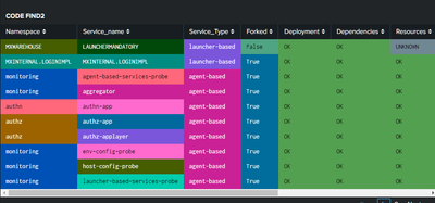

HI @SplunkingKnight
Not sure what I am doing wrong here. I am setting it in local on my app.
But I am getting this on a startup.
An the colors are still very bright.
I am using this to applay it
any help would be great -
