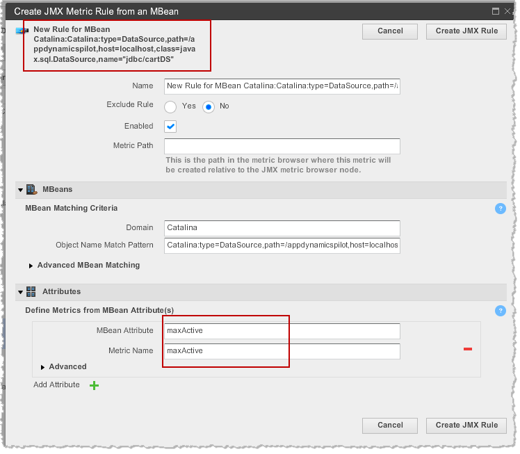

The persistent JMX metrics created from MBeans follow the same life cycle as other AppDynamics monitored entities. The following logs are for an example JMX metric "jdbc/cartDS" created for Node-8003 of the ECommerce tier on the DataSource MBean using the MaxActive attribute.
Searching in the agent log using the assigned name "jdbc/cartDS", you can find log entries similar to the following examples.
The MBean details appear in this entry:
[AD Thread Pool-Global1] 03 Oct 2013 14:30:43,646 INFO ManagedObjectFactory - Instantiated JMX Managed object for bean=JDBCConnectionPool, category=JDBC Connection Pools, instance=Catalina:class=javax.sql.DataSource,host=localhost,name="jdbc/cartDS",path=/appdynamicspilot,type=DataSource
This log snippet shows the attribute and the MBean pattern that was used to create the JMX metric. You can search on the metric name that you assigned. You can also search for "JMXMetricRepository" and it will show you the rule that was added as shown here:
[AD Thread Pool-Global1] 03 Oct 2013 19:50:46,247 INFO JMXMetricRepository - Added new JMX Rule [JMXMetricRule [ MBeanQuery [MBeanQuery [ domain [Catalina], mbeanPattern [Catalina:type=DataSource,path=/appdynamicspilot,host=localhost,class=javax.sql.DataSource,name="jdbc/cartDS"], queryLogicalOperator [AND], queryExpressions []]], metricCategory [Individual Nodes], beanName [null], metricPath [null], instanceName [null], instanceIdentifier [null], name [jdbcCart-DataSource], domain [Catalina] Attribute Definitions [ JMX Attribute Definition [mbeanAttributeName [maxActive], metricName [maxActive], metricTimeRollupType [AVERAGE], metricClusterRollupType [INDIVIDUAL], metricAggregatorType [AVERAGE], metricHoleType [null], getterChain [] ] ] ]]
