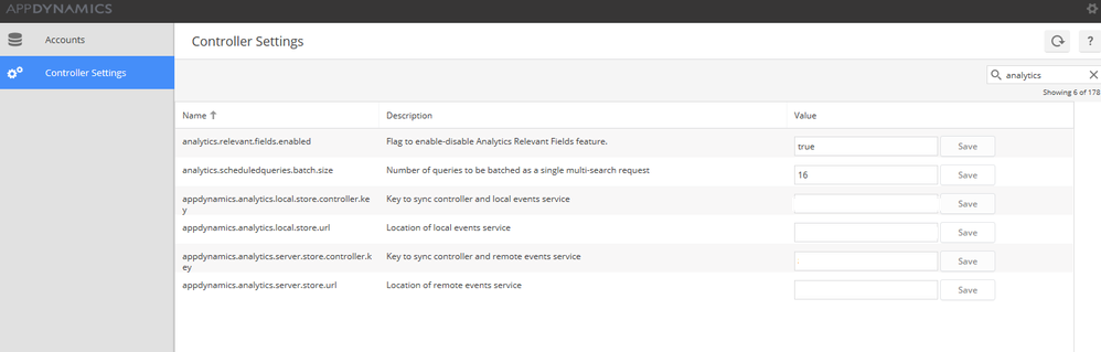

3) As with Analytics its recommended to use the standalone events service, so make sure that the following key values should match:
   a) ad.accountmanager.key.controller inside events-service-api-store.properties.
   b) appdynamics.analytics.server.store.key inside controller administrator console(admin.jsp).
4) Verify that the value for appdynamics.analytics.server.store.url inside controller administrator console should point to exact events service:
http://<events-service-host>:<events-service-port>
