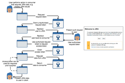

How does the authentication process work?
  1. In the authentication process, the resource owner grants access to their information on the resource by authenticating a request token.
  2. The consumer then uses the request token to obtain an access token from the resource.
  3. Once the client has the access token, (the client) can use it to make authenticated requests to the resource until the token expires or is revoked.

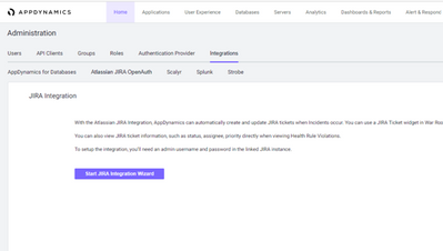

  1. To access the JIRA integration page, click Settings > Administration > Integrations.
  2. Then go to Atlassian JIRA OpenAuth (labeled 4, in the screenshot below) to access the JIRA Integration page”.
  3. Click the Start JIRA Integration Wizard button.

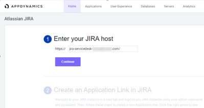

  4. To access the JIRA Host, enter the JIRA host URL into the field, then click Continue to verify connectivity to the JIRA host.
NOTE | Don’t include the leading HTTPS:// protocol string
A green checkmark below the Continue button confirms that JIRA connectivity has been established.

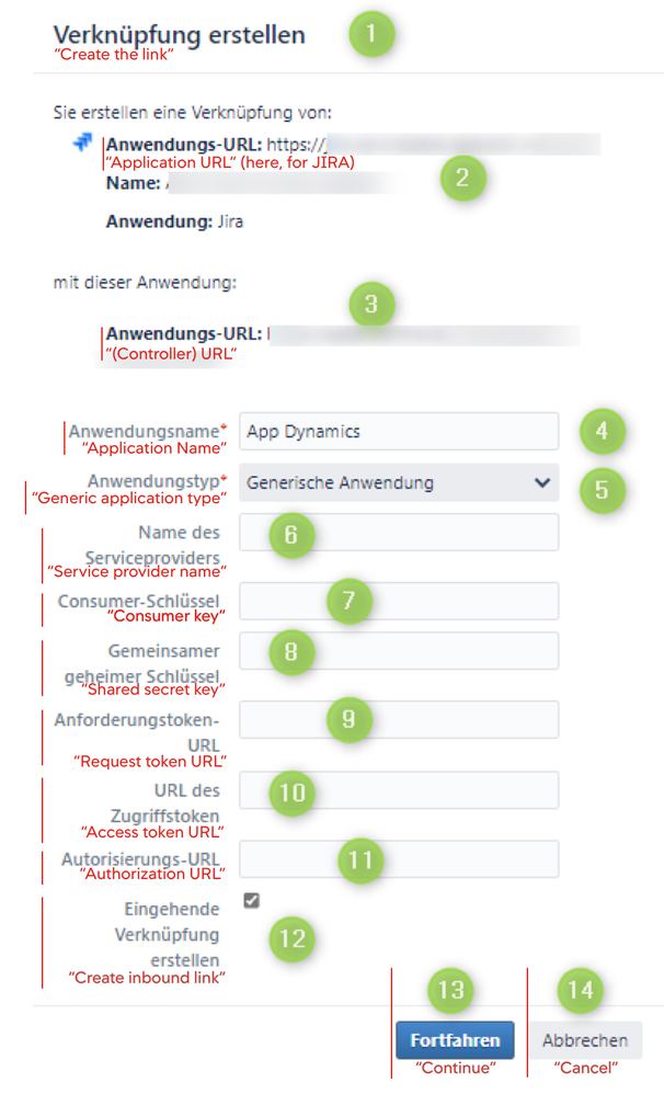

  2. In JIRA, create the application link.
    Enter the app name in the Application Name (4) and the Application Type (5) fields, and click the Create Incoming Link (12) checkbox. The other fields are optional. Then click on Continue (13) to enter the next step.
    image.pngThe (1) Create link dialogue box includes: (2) Application URL from JIRA; (3) Controller URL; (4) Application Name: e.g., AppDynamics; (5) Application Type: e.g., generic application; (6) Service provider name; (7) Consumer key; (8) Shared secret key; (9) Request token URL; (10) URL of the access token; (11) Autorization URL; (12) Create inbound link; (13) Continue; (14) Cancel
  3. To create the application link, enter the Controller credentials (which can be taken from the Controller JIRA Integration page), below:

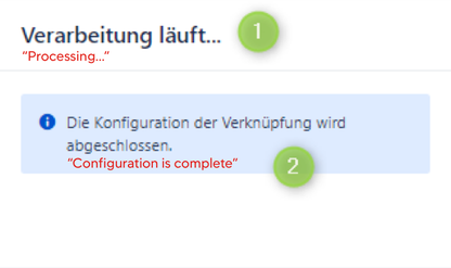

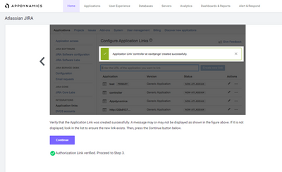

      A dialog will confirm that the application link was created successfully.image.pngThe (1) Processing dialog will indicate when the  (2) Link configuration is complet
    5. Once the application link is ready, click Continue.
      You will proceed to complete the next steps on the Controller
C. Establish JIRA Integration on the Controller
  1. Check to see whether the authorization link has been verified by looking for the GREEN checkmark shown under “Create an Application Link in JIRA”

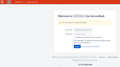

  2. Allow access to JIRA. Enter the JIRA username and password into their respective fields.

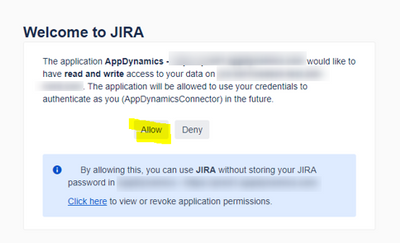

  3. On the JIRA side, click the Allow button to confirm read/write access to JIRA for your application.

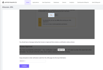

  4. From the Controller side, approve access. First, enter the offered verification code into the empty dialog field. Then, click the Continue button to complete the JIRA Integration process.
