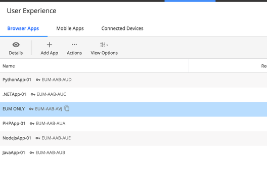

1. Click the Applications tab.
2. Click the Actions button and check the box "Include Applications from User Experience."
Note: You'll notice that the User Experience application named "EUM Only" is now listed.
3. Double-click on the EUM application.

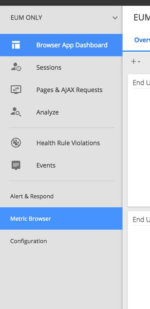

6. Click the User Experience tab and double-click on the EUM application.
7. Click the Metric Browser button.

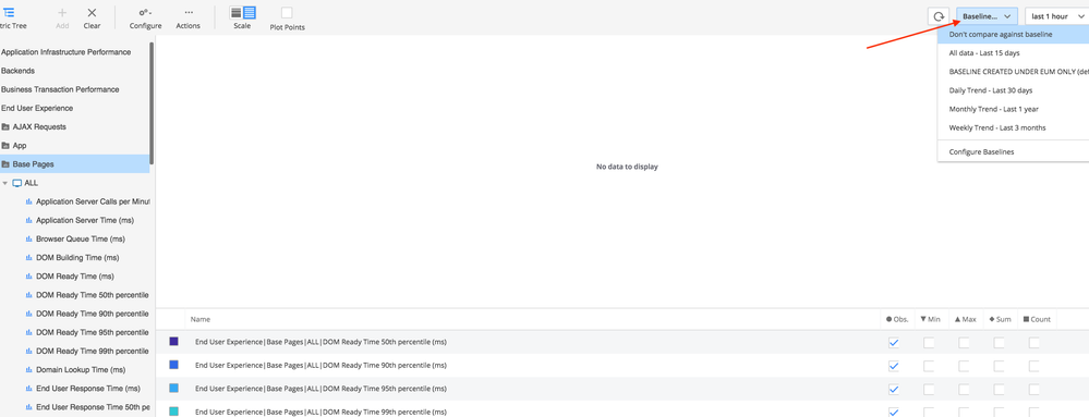

8. Verify that the new baseline exists for the EUM application via the drop-down menu in the top right corner.
9. Use the new baseline with EUM metrics.
