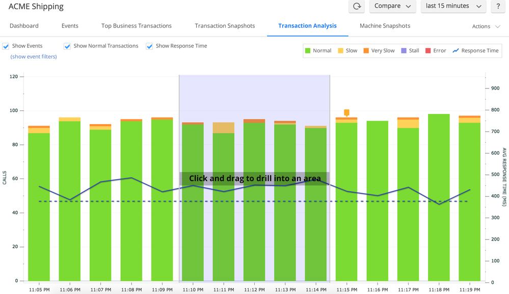

2. Look at any errors/exceptions happening around the same time as the crash that could be related to it. Transaction Analysis is a great place to get a combined view (see below). If the crash occurred before we could report the captured exception, you may not see anything there.
