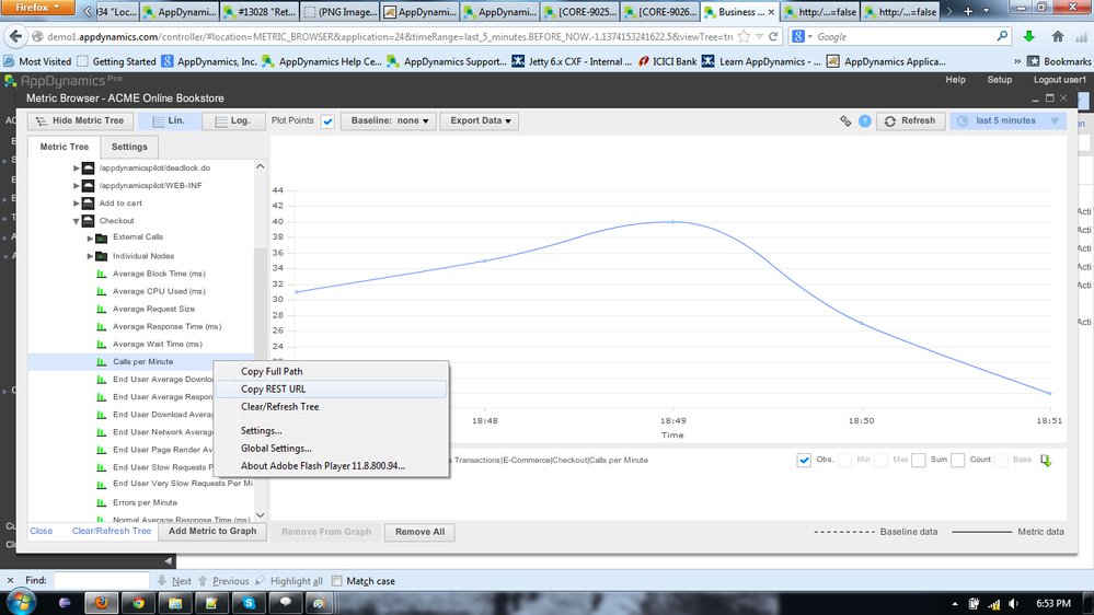

Adding to Angela comments above, regarding other query on the total number of calls query Can you please check if the following steps helps at tier or other component level as well from metric browser CPM metric:
Please validate and do let us know if the following instructions will help in achieving your requirement.

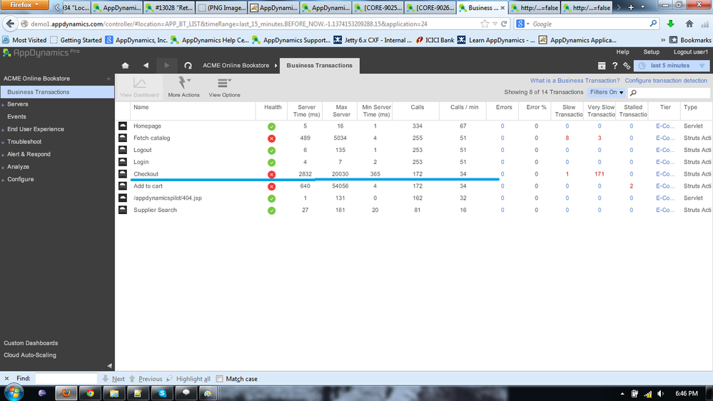

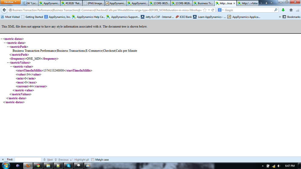

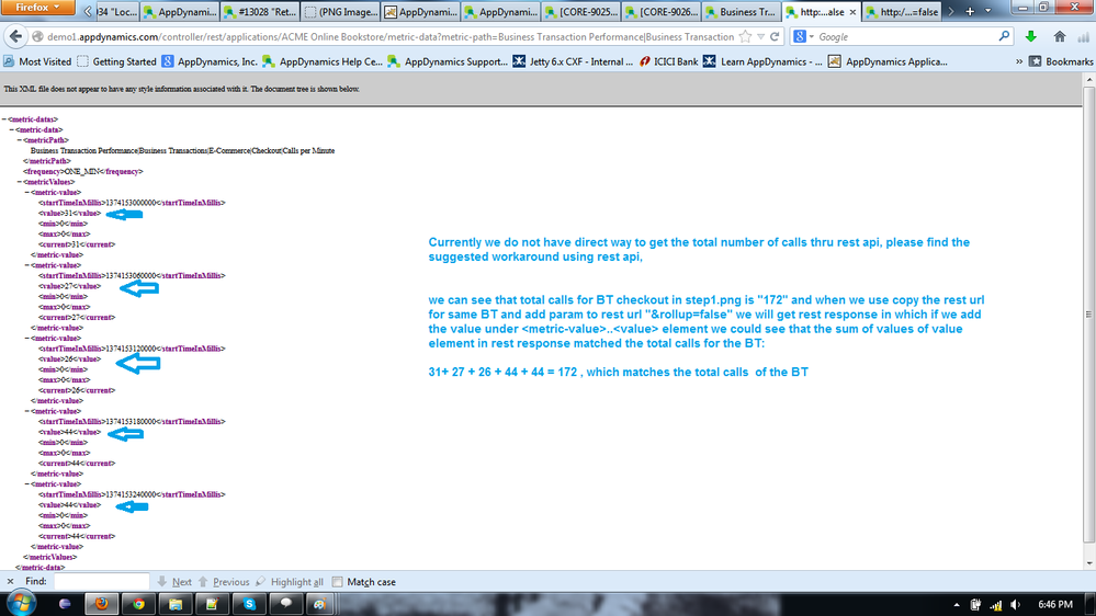

Step 1:- Navigate to the Analyze -> metric browser in UI, and select "<target BT - Information point>" -> "calls per minute" metric in Controller UI , and right click on the metric and select copy rest URL and past the url in browser tab and add parameter &rollup=false and sum the data discovered under <metric-value> <value> element which represents the total calls for each minute as referred in screenshots attached.
Step 2:- Prepare a custom metric using a custom script so as to read the value captured from REST API and manipulate accordingly that does the sum process of the value element as referred in step-1 above.
Step 3:- Report the manipulated value back to controller.
Step 4:- Design a custom dashboard for the reported new metric value for which you can use rest url as we have a metric now in metric browser.
