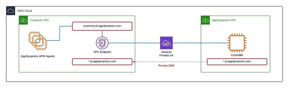

How do I configure agents to use AWS PrivateLink
By default, customers and their agents connect to a custom URL, such as customer.saas.appdynamics.com. This resolves to a public endpoint in front of the Controller, which accepts connections and passes them to the proper Controller service. In order to force them to use AWS PrivateLink, agents must be configured to connect to the PrivateLink VPC Endpoint created above instead of the Internet-facing endpoint.
AppDynamics uses the Private DNS feature of AWS to facilitate this data path. AppDynamics assigns a DNS entry to their VPC Endpoint and clients in the customer VPC can resolve that DNS entry to the corresponding VPC Endpoint that was created in their account. See the diagram below for details:
image.jpegAgent Connectivity Network Diagram
Agents in the customer VPC will be configured to connect to customer.pl.appdynamics.com as opposed to customer.saas.appdynamics.com. The pl.appdynamics.com domain is shared across the PrivateLink connection and any host in the customer VPC can resolve their Controller name to this endpoint as long as the following two options are configured in the customer VPC:
  • DNS Resolution
  • DNS Hostnames
You can verify these settings by viewing the Details section of your VPC in the AWS Console.
NOTE | It is imperative that agents connect to the same account name via PrivateLink that they do via the Internet. If your Controller’s name is customer.saas.appdynamics.com, agents must connect to customer.pl.appdynamics.com. If the “customer” value is not identical, agents will fail to connect to the Controller.
