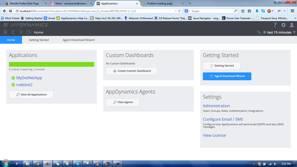

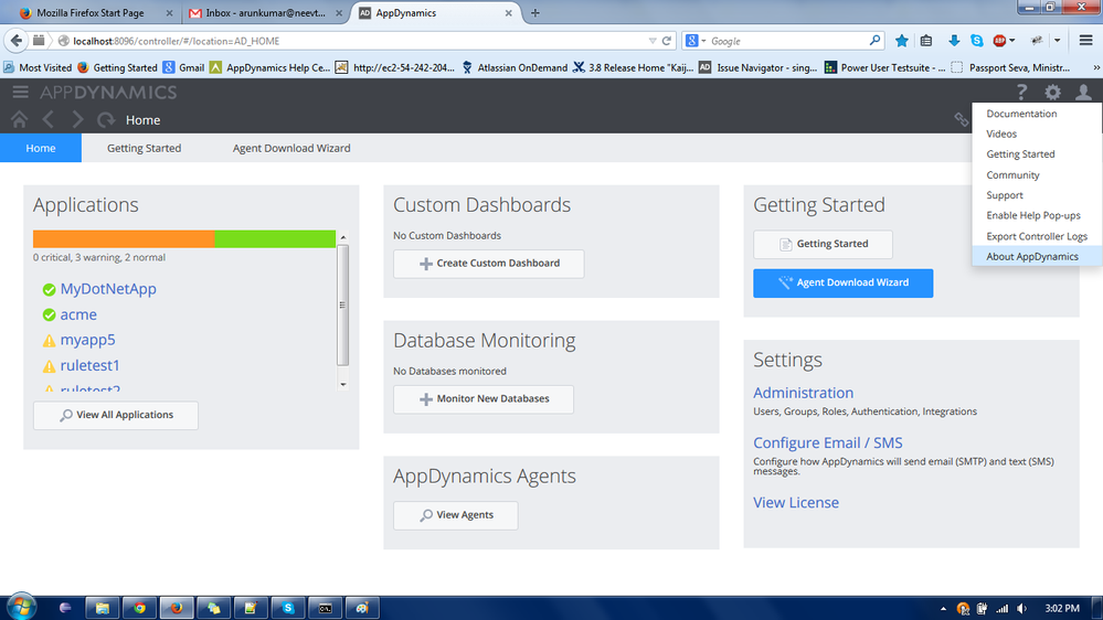

Hi,
I just replciate the issue and i could see the application name "Database Monitoring" in application table but found no "Database Monitoring" section  in 3.9.3 UI , this could due to feature hidden in latest version as this is in Beta.
results from local:
We request you to try and 3.9.1 version and see if that helps  to show the section in local controller.
Regards,
Arun
