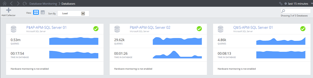

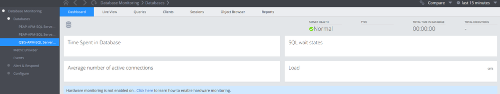

Currently the Database Agent is installed, and this is the error message we're getting since the installation and initial run:
14:42:06,453 ERROR [AD Thread-Metric Reporter0] DBEntitySubscriber:30 - HTTP Request failed: HTTP/1.1 500 Internal Server Error
They are all SQL Server 2012, the user is part of the SysAdmin role.
See that individually no data is shown on the "Dasboard"page
Log is also attached.
Please advise.
Thanks.
