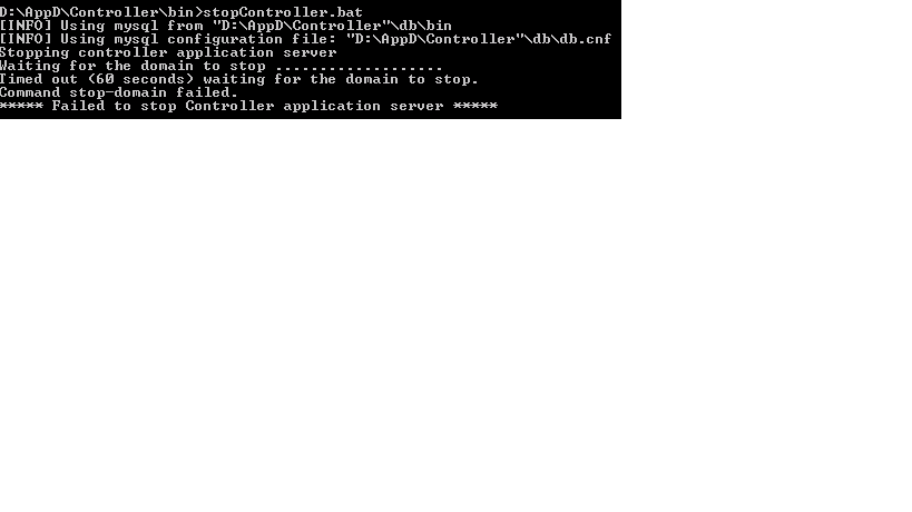

Controller not getting stopped showing timed out error in the command stop-domain

swarnavalli_sel
New Member
I was just trying to replace license file and trying to restart.
Controller UI is not loading ..
When i try to stop it is failing as above.
If i try to start it says already running.
i ran these commands and attached the output with this.
please find the logs attached.

swarnavalli_sel
New Member
I have followed the steps and it worked.
Controller started.
But UI is not loading.
What could be the reason for this.
It is taking time as in the attachment and not loading completly.It is in the same stage for an hour.
